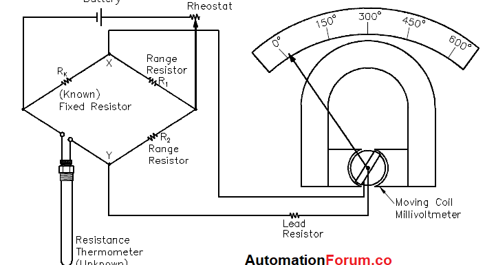

Two types of bridge circuits (unbalanced and balanced) are utilized in resistance thermometer temperature detection circuits:
Unbalanced bridge circuit:
The unbalanced bridge circuit uses a millivoltmeter that is calibrated in units of temperature that correspond to the RTD resistance.
The battery is connected to two opposite points of the bridge circuit. The millivoltmeter is connected to the two remaining points. The rheostat regulates bridge current. The regulated current is divided between the branch with the fixed resistor and range resistor R1, and the branch with the RTD and range resistor R2. As the electrical resistance of the RTD changes, the voltage at points X and Y changes. The millivoltmeter detects the change in voltage caused by unequal division of current in the two branches. The meter can be calibrated in units of temperature because the only changing resistance value is that of the RTD.
