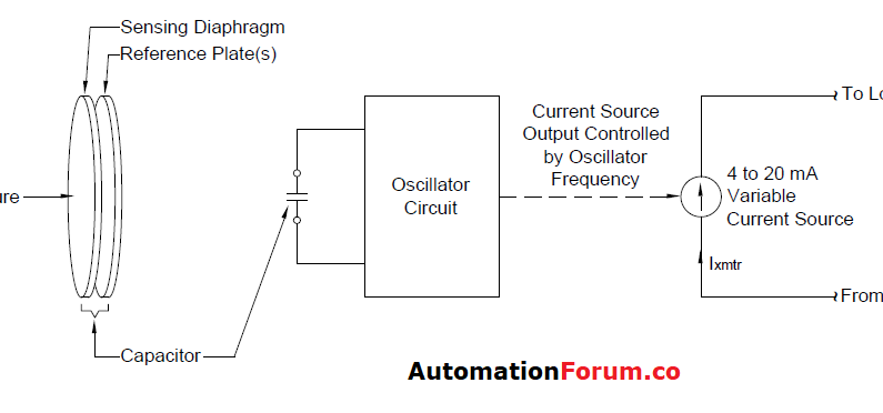

A typical process transmitter is a combination of a transducer, a translation circuit and a source of variable current. One measurable parameter is converted into another measurable parameter by a transducer.
Example:
The sensed pressure pushes on the sensing diaphragm, which is one of the plates in a capacitor. A condenser’s capacitance value changes as the distance between the plates changes, causing a change in the oscillator circuit frequency.
The translation circuitry adjusts the non-linearity of the transducer, the temperature variations and other factors to ensure that the 4 to 20 mA signal is accurate, repeatable and as linear as possible (in most cases)
