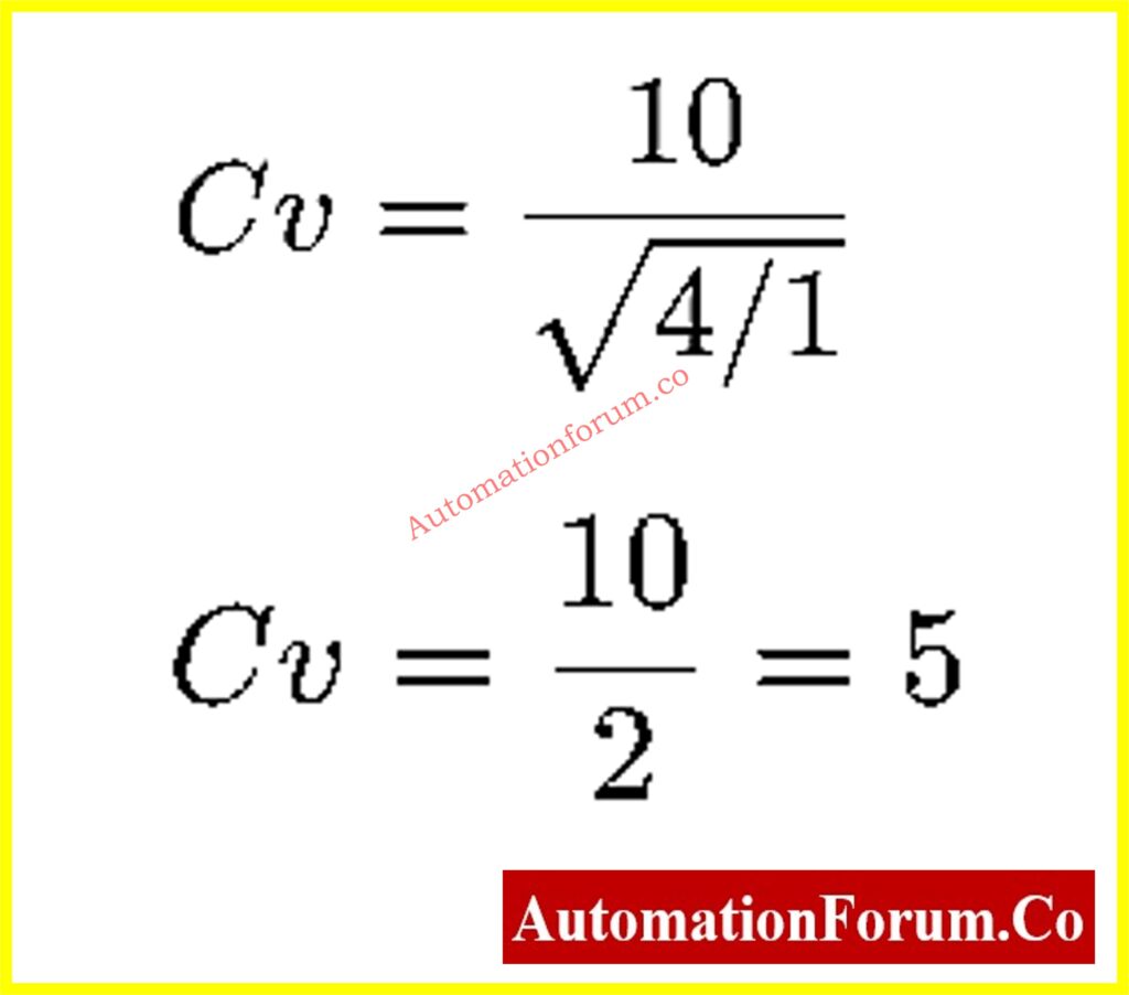

For example, If the flow rate (Q) is 10 GPM and the pressure drop (ΔP is 4 psi for water (SG=1):
Cv Formula 2
The valve requires a Cv of 5 to handle a flow rate of 10 GPM with a 4 psi pressure drop. This calculation helps engineers determine the appropriate valve size for the system.
