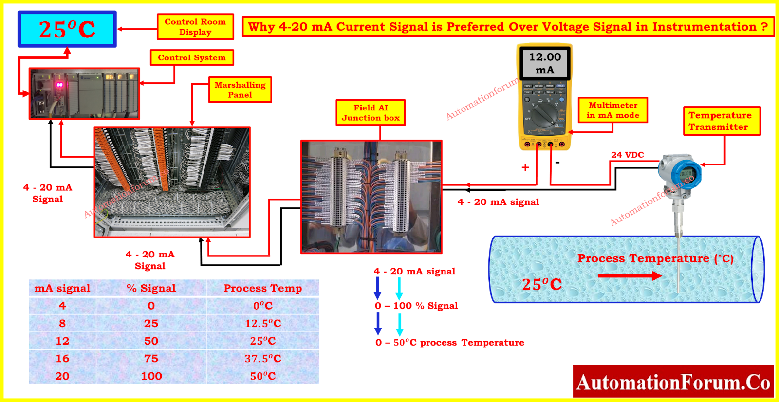

Current Signal Transmission: Superior Accuracy and Reliability
- The accuracy, reliability, and noise immunity of current signals are significantly higher than those of voltage signals.
- In particular, the 4-20 mA standard that is used for current signals offers substantial advantages.
- Let’s explore the reasons behind the widespread adoption of the 4-20 mA current loop in the industry in general.

Linear Response
- The linearity of the 4-20 mA signal also makes it ideal for industrial applications.
- The current signal maintains a linear relationship between the process variable and the signal being transmitted.
- This makes it easier to calibrate and more predictable when configuring control systems such as PLC (Programmable Logic Controllers) and DCS (Distributed Control Systems).
- For example, in a temperature measurement system using a 4-20 mA transmitter, 4 mA could correspond to 0°C, while 20 mA corresponds to 100°C.
- The range in between can be easily divided and calculated linearly, providing an accurate representation of the process variable.

Why 4-20 mA Instead of 0-20 mA?
While it is possible to use a 0-20 mA signal for transmission, the 4-20 mA standard has become the norm for several reasons:
Detection of Wire Breaks
- One of the most significant advantages of using a 4-20 mA signal is its ability to detect open circuits or wire breaks.
- In a 4-20 mA loop, a signal of 0 mA indicates a problem, such as a disconnected wire or a power failure, which immediately alerts operators or the control system.
- On the other hand, in a 0-20 mA system, a 0 mA signal could either indicate the lower range of the process variable or a failure, leading to potential confusion and delayed response times.

Compatibility with PLCs and DCS Systems
- In most control systems, especially those using PLCs or DCS, the 4-20 mA signal is easily converted to a voltage signal for analog-to-digital conversion.
- This is usually done using a 250-ohm resistor in the circuit, which converts the current into a 1-5V signal (Ohm’s Law: V = IR).
- The resulting voltage signal is fed into the control system’s analog input module for processing.
