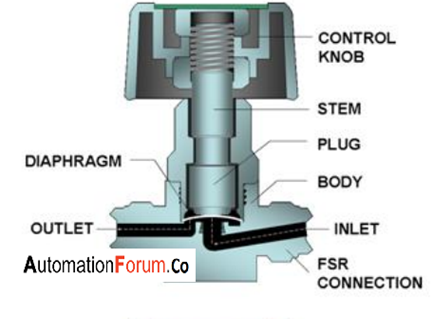

What are the parts of the diaphragm valve ?
- Valve body
- Bonnet
- Weir-seat
- Diaphragm-disc
- Stud
- Plunger
- Stem
- Actuator
How diaphragm valves are constructed ?
The diaphragm valves are manufactured in a wide variety of materials to suit the particular media. The valve body is constructed according to the service requirements. Mostly corrosion resistive materials are used for valve body construction. Mostly bonnets are made up of cast iron and epoxy coated inside and outside, diaphragms are mostly made up of elastomers and plastics. The elastomeric mechanical properties will be lowered at high temperatures.
How diaphragm valves work ?
The flexible diaphragm is connected to a support member and that is the compressor, which represents the closure member. If the valve is opened then the diaphragm is lifted out of the flow path and the fluid will flow streamlined. When the valve is closed then the diaphragm is tightly seated against the seat in the body known as the weir. The valve will be closed completely when the diaphragm is forced downward. There is no need for stem packing in this valve because there is no valve stem in the flow path. While compared to other conventional valves these valves require less maintenance. The material which is used to construct the diaphragm is a mostly rubberized compound so these valves can be used where highly corrosive materials are present.
