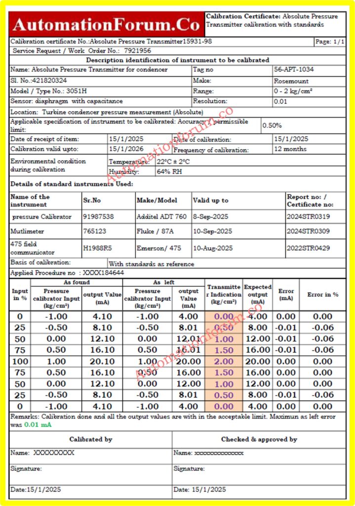

Absolute Pressure Transmitter Calibration - Sample Calibration Report
This report documents the calibration of an Absolute Pressure Transmitter to ensure its accuracy and compliance with operational standards with following minimum example data.
  • Transmitter Model: Absolute Pressure Transmitter FKA
    Serial Number: 12345XYZ
    Calibration Range: 0-760 Torr
    Calibration Equipment: Digital Calibrator, HART Communicator
  • Special Note: Initial output readings were recorded as 4.002 mA for the lower range value (LRV) and 20.050 mA for the upper range value (URV). Post-adjustment, the output was corrected to 4.000 mA (LRV) and 20.000 mA (URV). The output deviation was within ±0.05% of the calibrated range.
  • During the calibration process, no physical damage or abnormal wear was observed on the transmitter. The device is functioning within acceptable parameters after adjustment.
  • Calibrated by: [Technician Name]
    Date of Calibration: [DD/MM/YYYY]
    Signature:
This report should be retained for compliance and audit purposes. Any future deviations or issues should be addressed promptly to ensure continued reliability.
