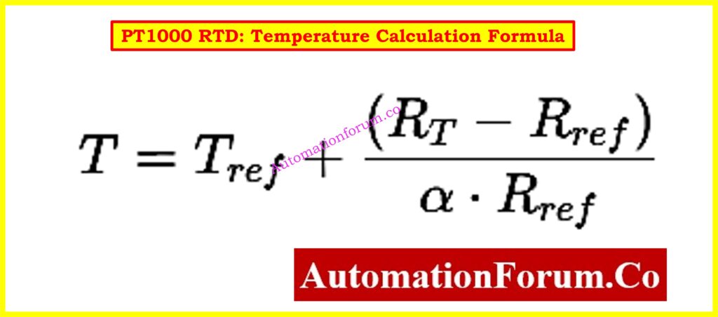

PT1000 RTD: Temperature Calculation Formula
This calculator utilizes a linear approximation, which works well for temperatures that aren’t too high or too low. The formula that is usually employed is:
Where:
- T = Calculated process temperature in degrees Celsius
- RT= Measured resistance of the RTD (in ohms)
- Rref = Reference resistance of the RTD at reference temperature (500 ohms at 0°C for PT500)
- α = Temperature coefficient of resistance (commonly 0.00385 for platinum RTDs)
- Tref = Reference temperature, typically 0°C
Example Calculation for PT1000 RTD
Let’s work through a real-world example:
- Rref = 1000 Ω
- Tref = 0°C
- α = 0.00385
- Measured RTD resistance, RT = 1077.0 Ω
T=0+{(1077−1000)/(0.00385×1000)}
T=77/3.85=20°C
So, for a measured resistance of 1077 Ω, the PT1000 RTD corresponds to a temperature of approximately 20°C.
