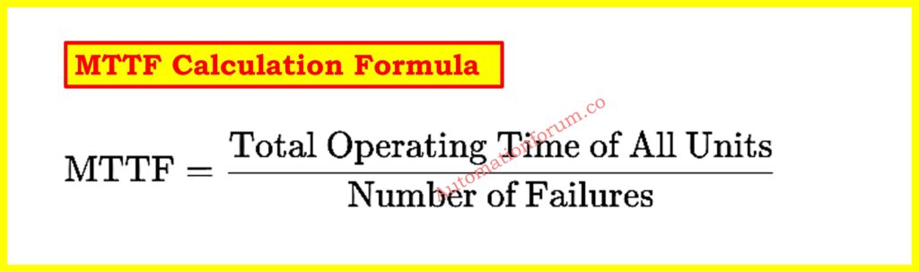

MTTF Calculation Formula
Where:
- Total Operating Time = Sum of all usage hours before failure
- Number of Failures = Number of failed units in that observation period
Note: MTTF is used only for non-repairable items. If the item can be repaired and reused, use MTBF (Mean Time Between Failures) instead.
