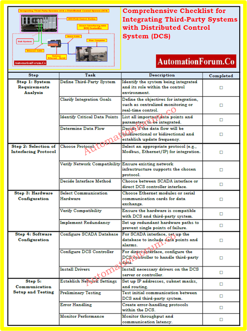

Based on your system needs and operational priorities, you can choose the best integration solution by being aware of these techniques and their unique benefits and drawbacks.
It is essential to stick to a thorough checklist when integrating third-party systems with a DCS in order to minimize potential risks and ensure effective deployment. This checklist guarantees that all technical issues are covered. An extended checklist to help with the integration process is provided below:
  • Define the third-party system you are integrating with the DCS, such as MPFM, compressors, or power generation units. Understand its specific role and function within the control environment.
  • Clarify the goals of integration, such as centralized monitoring for unified oversight, data aggregation for enhanced analysis and reporting, or real-time control to influence and monitor the third-party system.
  • Identify all critical data points and parameters from the third-party system that need to be integrated with the DCS. Examples include mass flow rate and density for MPFM, or bearing temperature and engine lube oil pressure for compressors. Ensure you understand the type of data (analog, digital, alarms) and accuracy requirements.
  • Decide the direction of data flow between the third-party system and the DCS whether unidirectional (from third-party to DCS) or bidirectional (allowing communication in both directions). Establish data update frequency and how the DCS will handle and process this data.
  • Choose a suitable protocol for integration, such as Modbus, Ethernet/IP, or Profibus, considering factors like system compatibility, data rate, and reliability requirements.
  • Verify that the existing network infrastructure supports the selected protocol and can accommodate the additional data load without performance issues or degradation.
  • Decide whether to use a SCADA interface (where the DCS server acts as an intermediary) or a direct DCS controller interface based on factors like data criticality and the level of interaction required.

  • Choose the appropriate communication hardware, such as Ethernet modules or serial communication cards, for both the DCS and the third-party system to facilitate data exchange.
  • Verify that the selected communication modules are compatible with both the existing DCS hardware and the requirements of the third-party system to ensure seamless integration.
  • Implement redundant hardware paths where necessary to prevent single points of failure, especially in critical applications, to enhance system reliability and uptime.
  • For a SCADA interface, configure the SCADA database to include data points, alarms, and historical data from the third-party system. Ensure that all relevant data is accurately represented and accessible.
  • For direct interfacing, configure the DCS controller to handle third-party data by setting up the necessary logic and communication parameters. Ensure the controller is programmed to process and respond to data from the third-party system effectively.
  • Install and configure the required drivers on the DCS server or controller to enable communication with the third-party system. Ensure that the drivers are compatible and properly set up to support seamless data exchange.
  • Establish and set up network settings, such as IP addresses, subnet masks, and routing, to guarantee that the DCS and external systems communicate with each other. Check to make sure devices can be reached and that the network settings are correct.
  • To ensure that the DCS can send and receive data from the third-party system successfully, run preliminary testing. Look for problems with connectivity and confirm that data exchange is operating as it should.
  • Create error-handling protocols inside the DCS to handle faulty data or poor communication. Establish alerts or alarms to inform operators about issues and, if required, set up retry procedures.
  • Monitor throughput and communication latency to make sure they fulfill the performance needs of the application. Check that reaction times and data transfer rates fall within reasonable bounds for effective functioning.
  • Verify that the integrated system performs as expected by ensuring all data points from the third-party system are accurately transmitted and displayed in the DCS.
  • Simulate both normal and peak operational loads to assess system performance. Identify potential bottlenecks or overload issues to ensure the system can handle expected traffic.
  • Confirm that alarms, events, and status signals from the third-party system are correctly processed by the DCS. Check that they trigger appropriate responses and are displayed accurately.
  • If redundancy measures are in place, test the failover mechanisms to ensure the system maintains continuous operation during hardware or network failures. Validate that backup systems activate seamlessly and without interruption.
