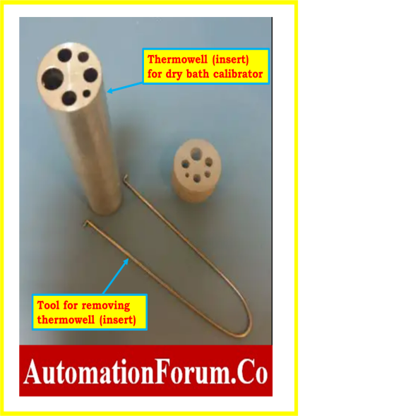

Tools Required for Temperature Switch Calibration
Prepare the following instruments and accessories before starting calibration.
- Calibrated dry block temperature calibrator.
- Calibrated reference thermometer.
- Standard reference thermocouple.
- Digital multimeter with continuity and resistance measurement.
- Thermocouple sockets and connectors.
- Test probes and connecting leads.
- Appropriate thermowell or temperature insert.
- Necessary hand tools.
- Soft cleaning cloth.
- Calibration report template.
The reference thermometer and temperature calibrator must have suitable ranges and accuracy for the required calibration tolerance.

Prepare the Calibration Setup for Temperature Switch
- Collect the required equipment, including a dry bath calibrator, a thermowell of the right size for a temperature switch, a thermometer with the appropriate range and accuracy, a power source, a standard thermocouple, and the probes and connectors needed to attach the temperature switch to the calibrator and thermometer.
- Ensure sure the temperature switch and calibrating test equipment are clean of any debris or residue that might affect the calibration’s precision.
- Plug the dry bath calibrator into an electrical socket to turn it on.Verify the correct operation of the dry bath calibrator and the accuracy of the temperature control.
- As you place the temperature switch into the dry bath calibrator with the suitable thermowell, make sure the sensing element is entirely submerged in the bath and not touching the walls or bottom of the container.
- Connect the temperature switch to the multimeter in continuity or resistance mode using the appropriate probes and leads. Verify the leads, probes, and temperature switch are in fine shape, and that the connection is stable.
- To measure the temperature of the dry bath calibrator, insert the standard reference thermocouple with a standard thermometer in the same location as the temperature switch. Verify the thermometer’s accuracy and resolution to ensure they are appropriate for the calibration process and that it has been calibrated.
- The temperature displayed by the dry bath calibrator should be compared to the reading from the standard thermometer.
- The setup is ready for calibration of the temperature switch if the thermometer and dry bath calibrator are steady and the temperatures coincide.
