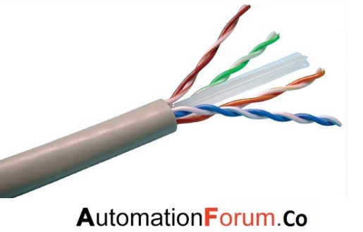

Twisted Pair (shielded and unshielded)
Twisted pair, as its name implies, consists of a pair of insulated copper wires twisted together to minimize the effects of electromagnetic interference. A cable is a number of such pairs grouped together in a bundle and wrapped in a protective sheath. A shielded pair of wires protects the signal from unwanted noise generated from electromagnetic interference (EMI) and radio frequency interference (RFI). The shield is made of metallized polyester or of a metallic
woven material. EMI is created when the wires are in close proximity to electrical motors and fluorescent lighting. RFI is generated by radio equipment such as walkie-talkies.
Twisted pair is typically used in point-to-point wiring and within a single building. For longer distances, coaxial or fiber optic is used—however, they are more expensive than the twisted pair. Twisted pair can transmit both analog and digital signals and the shielded type has excellent noise immunity. The star, bus, and ring network topologies can all use twisted pair.
