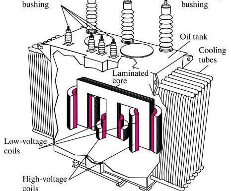

Substantial improvement is obtained when the transformer is immersed in an oil tank. The oil reaches the conductor surface and extracts the heat and transports the same to the surface of the tank by convection. This is termed as ON (Oil Natural) type of cooling. This method permits the increase in the surface available for the cooling further by the use of ducts, radiators etc.
