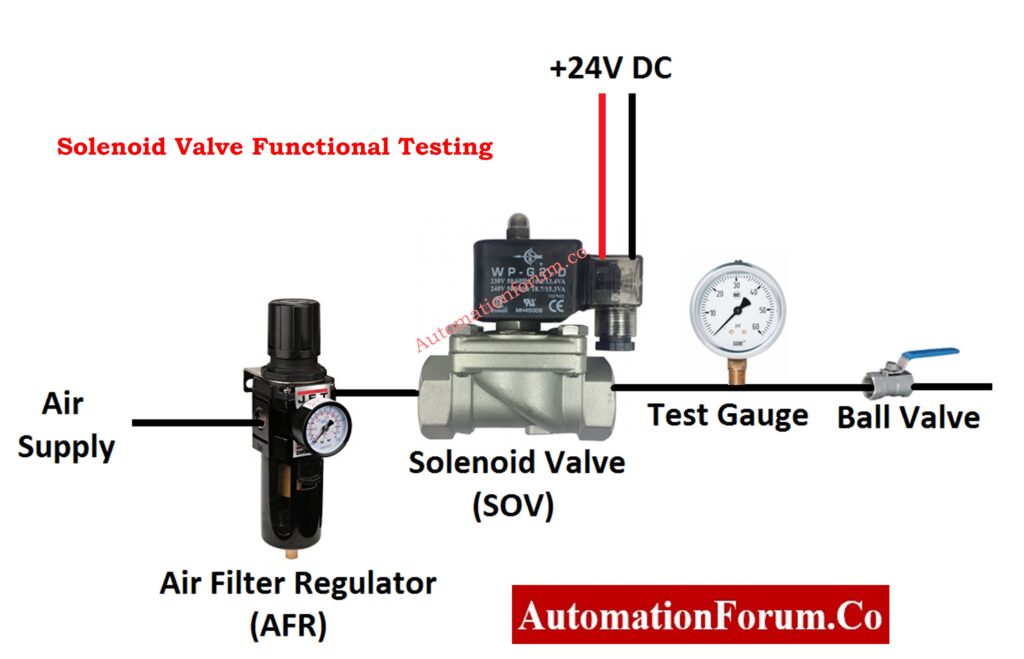

This guide explains how to perform a reliable functional test on a solenoid valve using instrument air. The procedure covers the recommended test setup the step by step operation what to record and basic troubleshooting. See the attached image for a typical test layout showing the Air Filter Regulator AFR the solenoid valve the test pressure gauge and the ball valve.

Typical test setup see attached image
- Connect the plant or bench air supply to the AFR inlet.
- Set the AFR to the required test pressure.
- Run the AFR outlet to the solenoid valve inlet.
- Fit the test pressure gauge at the solenoid valve outlet.
- Place a ball valve downstream of the gauge to allow isolation.
- Connect the solenoid coil to the 24 V DC supply using safe wiring and a switch.
