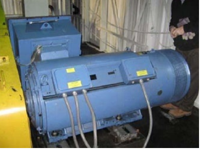

What is an electric drive
An electric motor along with its controller is called as electric drive, an electric drive can be defined as a form of machine equipment which is designed to convert the electrical energy to mechanical energy and it will also provide electrical control of this process
