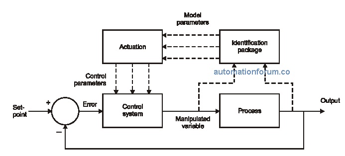

Adaptive control is based on the development of a compensating adjustment through knowledge of a disturbing factor or on the basis of loop response itself. A system that adapts itself on the basis of a measurement of a disturbing factor is referred to as programmed system.
A system that uses a measurement of its own performance is termed self-adaptive.
On the other hand, self-adaptive systems must sense variations in plant behaviour.This is what identification is  and it is normally a partial measurement  e- cause total identification is either too complex or impossible. After identification, the adaptive device or system must be able to adjust some controller parameter or function. This is referred to as actuation and is illustrated in the schematic diagram of  fig below
In a real sense, programmed adaptive control is feedforward in nature, while self adaptive is feedback.
