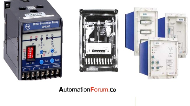

How do protective relays work and what is relay principle
There are different types of protective relays and some of them are different in their operation method such as an electromechanical relay does its operation by either magnetic attraction or by magnetic induction. Armature type relay has a pivoted lever supported on a hinge or knife edge pivot, which carries a moving contact. Armature relays could work in either AC or in DC. Relay works as a protective switch and they are used in power systems, but in certain cases relays are used as sensing devices such as in higher power applications, so in case of any abnormal condition the relay would sense it and sends the signal to the circuit breaker. Protective relay senses the fault position and gives a signal to the circuit breaker, the circuit breaker will disconnect the faulty portion after receiving the signal
