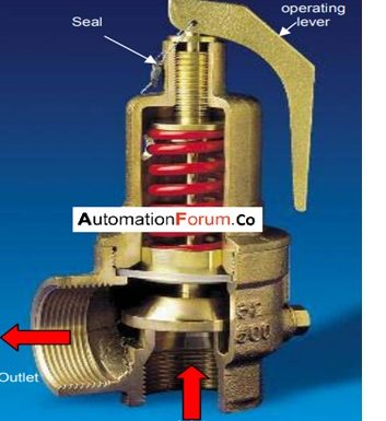

 Pressure Relief Valve
  • Under normal conditions, pressure relief valves remain closed, only opening when the fluid pressure exceeds the setpoint. They keep systems safe by releasing excess pressure and then closing to return to normal levels.
  • These valves are used so that the overpressure of the liquid can be relieved. The operation of the pressure relief valve under normal conditions, like when the system pressure is normal the pressure relief valve will stay close with the help of a spring.
  • The valve would open when the pressure of the fluid pushes the spring. The force or pressure required to open the valve is setpoint pressure. The setpoint pressure is the maximum normal operating pressure of the liquid.
  • When the fluid pressure is more than the setpoint pressure then the valve will open slowly and the pressure is brought back to its normal level. Spring force is changed with the help of adjustment screw in case of different set point pressure. Think of it as a safety valve on a kettle, releasing excess pressure to prevent a catastrophic ‘boil-over.’
Pressure Safety Valve
  • These valves can relive the overpressure of gasses and vapors, in this valve the setpoint is greater than the maximum normal operating pressure of the process fluid, but it is less than the maximum safe operating pressure of the equipment.
  • If the fluid pressure is more than the setpoint pressure then the valve opens fully. So this can decrease the overpressure very fast and after that, the valve will close.
  • The pressure at which the valve closes after the reducing process is less than the setpoint pressure. The difference between the opening and closing pressure is called blow-down.
  • Most of the pressure control valves have their outlet diameter bigger than the inlet so that pressure can be reduced.
