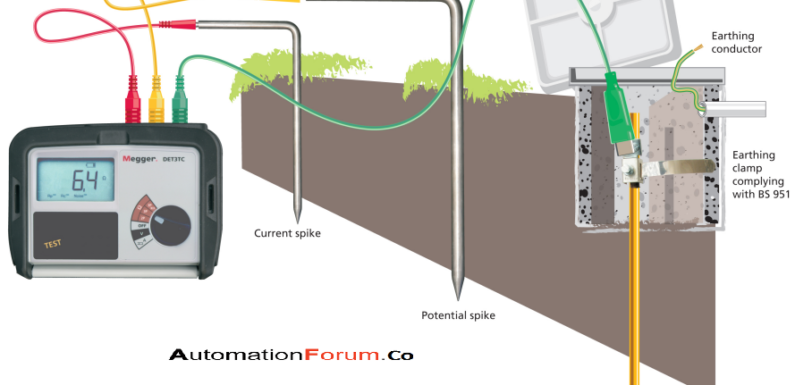

What are the applications of a megger
  • Primary current injection testing of protective systems
  • Testing of circuit breaker
  • Motor and alternator testing
  • Testing of generator and transformer
  • Heat runs
  • Safety ground device can be tested
  • Ground grids can be tested
  • Protective relays can be tested
  • It can measure the electrical resistance of insulators
  • Installations for winding
  • Earth ground connection can be tested
