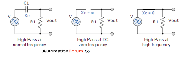

High pass filter
A high pass filter will only pass high-frequency signals and it will block or impedes low-frequency signals. A high pass RC filter will only pass high-frequency signals and its circuit is composed of a resistor and a capacitor. To create this circuit capacitor is placed in series with the power signal that enters the circuit. The capacitor provides high resistance to low frequency or DC signals, and it will provide low resistance to high-frequency signals. The operation of active high pass filter is the same as the passive high pass filter except the active high pass filter uses an op-amp in it.
