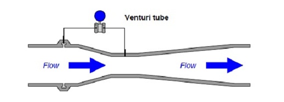

THE CLASSIC VENTURI TUBE
The venturi tube, as designed by Clemens Herschel in 1887.
It consists of
  • A cylindrical inlet section equal to the pipe diameter
  • A converging conical section in which the cross sectional area decreases, causing the velocity to increase with a corresponding increase in the velocity head and a decrease in the pressure head
  • A cylindrical throat section where the velocity is constant so the decreased pressure head can be measured
  • A diverging recovery cone where the velocity decreases and almost all of the original pressure head is recovered
The classic venturi is  manufactured with a cast iron body and a bronze or stainless-steel throat section. At the midpoint of the throat, six to eight pressure taps connect the throat to an annular chamber so that the throat pressure is averaged. The cross-sectional area of the chamber is 1.5 times the cross-sectional area of the taps. Because there is no movement of fluid in the annular chamber, the pressure sensed is strictly static pressure.
Usually, four taps from the external surface of the venturi into the annular chamber are made. These are offset from the internal pressure taps. Throat pressure is measured through these taps. This flow meter is limited to use on clean, noncorrosive liquids and gases, because it is impossible to clean out or flush out the pressure taps if they clog up with dirt or debris.
