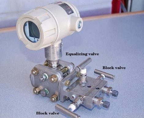

Applications of 3-way valve manifold:
A 3-way valve manifold is used for a differential pressure transmitter. The typical 3-way valve manifold consists of 2 block valves and 1 equalizer valve.
  • To check the zero of the differential pressure transmitter, close the block valve and open the equalizing valve.
  • The 3-valve manifold is rarely used in the oil and gas industries, especially on offshore platforms, due to the absence of a test connection.
  • Some companies altered the 3-valve manifold, by providing a plugged test connection.
Applications of 5-way valve manifold:
The 5-way valve manifold is also used for a differential pressure transmitter. The typical 5-way valve manifold consists of 2 block valves, 1 equalizer valve, and 2 vent or test valves.
  • To check the zero of the transmitter, close the block valve and open the equalizing valve.
  • To calibrate the transmitter for 3 or 5 point calibration, after the pressure is equalized, connect the test valve to a pressure generator.
  • This 5-way valve manifold is the most common valve manifold for a differential pressure transmitter.
