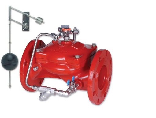

The Level Control Valve with Bi-Level Vertical Float is a hydraulically controlled, diaphragm actuated control valve that controls reservoir filling in response to a hydraulic on/off float pressure command. The Valve opens at pre-set low level and closes at a pre-set high level
Operation
It is a float-controlled valve equipped with a “last position” two-way floating pilot assembly. The float [1] slides along the rod [2]. When the float reaches the high adjustable level stops [3] or low [4], pull the bar assembly down or push it up, changing the position of the float pilot [5]. When the float is between the adjustable stops, the main valve remains in its last position. At the high level, the float pilot applies pressure to the control chamber [6], powering off the main valve. At low level, the float pilot ventilates the control chamber, opening the main valve powerfully. For valves 8 “or larger, an accelerator [7] accelerates the response of the valve.
