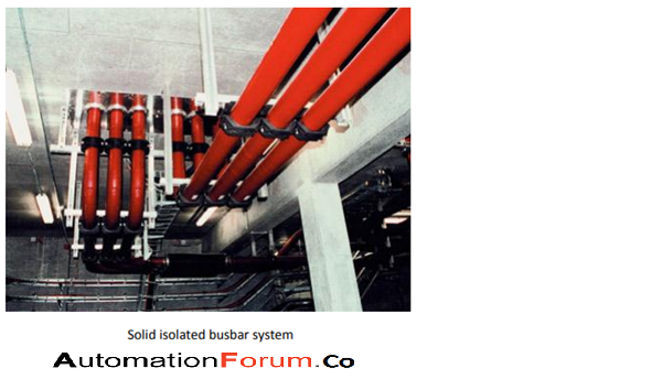

Bus-bar connection
Bus-bar could be supported on insulators or insulation could be surrounded it completely they are protected from accidental contact by a metal earthed enclosure. Neutral bus-bars could be insulated too. Bus-bars could be enclosed in metal housing in the form of bus-duct or busway segregated phase bus or isolated phase bus. Bus-bars could be connected to each other and to electrical apparatus by a bolted clamp or welded connections
