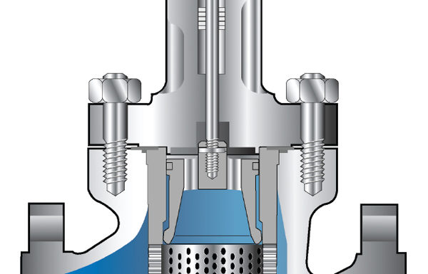

Related image
Air bubbles produced by cavitation always cause damage because they move at high speed. The damage will be even greater if the bubble experiences an impulsion (opposite of the explosion) on the valve wall.
Cavitation can be prevented by using components that can prevent the high-pressure drop. One type of component is a backpressure device that functions to localize bubbles so as not to collect and force implantation to occur in capillary pipes/holes such as cavitation control images (a) process, (b) equipment.
Flashing:
In fluid flow, when the fluid pressure is equal to or less than the vapour pressure, there is a steam bubble in the area. If the recovery pressure is above the vapour pressure, cavitation will occur. But if the recovery pressure is still below the vapour pressure, the vapour bubble will persist not to experience impulsion. This condition is known as flashing. Damage caused by flashing is known as erosion, as shown in the picture. Unlike cavitation that can be overcome by adding a component, the control of flashing requires total modification of the system valve.
