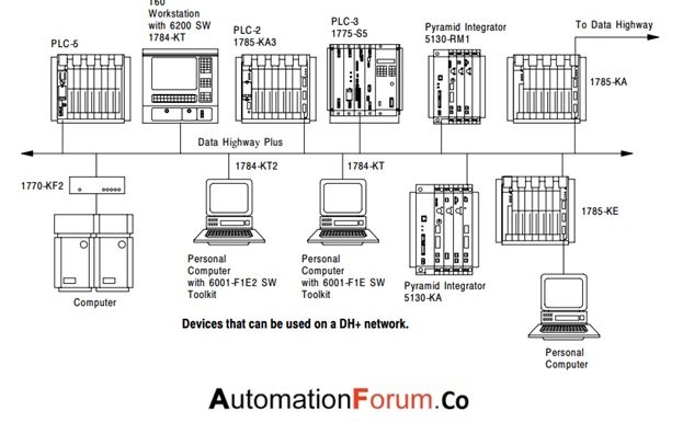

DH+ Overview
Devices Used on DH+
How Nodes Communicate on DH+
DH+ uses token-passing protocol to allow nodes on the network to transmit messages over the cable. With token-passing protocol, only the node possessing the token can transmit messages. As long as a node possesses the token, it is the master. This is rotation of link mastership. When a node has sent all of its messages or used all of its token-hold time, it passes the token to the node with the next highest address. Token passing continues in this manner until the token is passed to the node with the lowest address. When the node with the lowest address is finished with the token, the cycle begins again. On DH+, the interface modules control access to the network locally. This means if one module faults, the other modules continue to communicate on the network.
A message from a node on one network to a node on another network uses message transmission time in both networks. To achieve the best network performance, configure each network so that a minimum of messages cross between them. You can do this by grouping stations that need to frequently communicate with each other on the same network.
