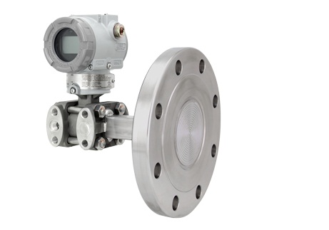

Diaphragm Seal assembly in Differential Pressure  transmitter .
1.Balanced DP system
2.Unbalanced DP system
Where seal, mount, capillary, or fill is not identical. A complete assembly includes one diaphragm seal on the HP side AND one diaphragm seal on the LP side.
Diaphragm Seal assembly in Pressure  transmitter .
