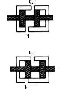

2.Two Way Valves
Has two ports
Are Manually operated , Pilot operated or Solenoid operated
Either Normally Open or Closed
In one position IN and OUT ports are connected
In another position, IN and OUT ports are isolated

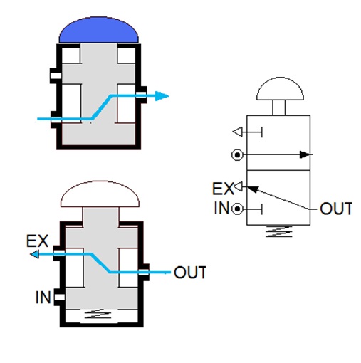

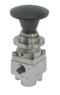

4.Manually Operated 3 Way
Manual ‘push’ changes the normal position of the valve
In a spring return valve, position returns to normal condition on manual release.
3 way Valve Paths

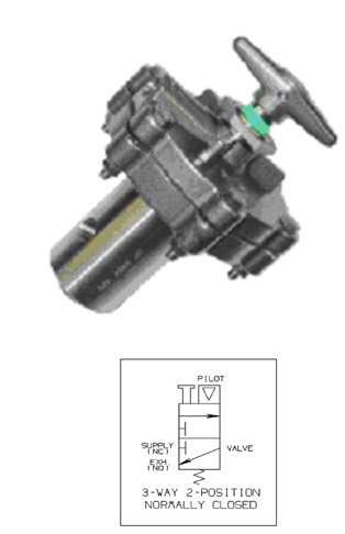

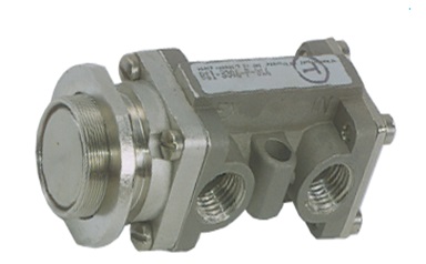

5.Pilot Operated 3 way
The pilot is opposed by a spring tension, which returns the valve to its normal position on pilot removal

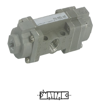

6.Pilot Operated Pilot Return
No spring to return the Valve
2nd Pilot used to return the valve
Port configuration is stay put until next pilot

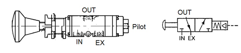

9.Manual Reset Valve
Manual Reset essential to effect the pilot
Auto trip on loss of pilot

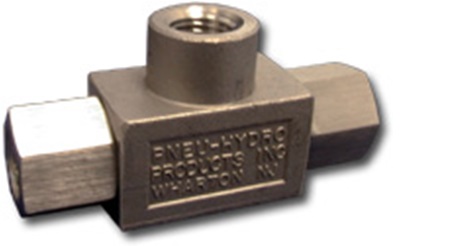

13.Shuttle Valve
Pneumatic equivalent of electronic OR gate
Presence of any one input yields an output.
