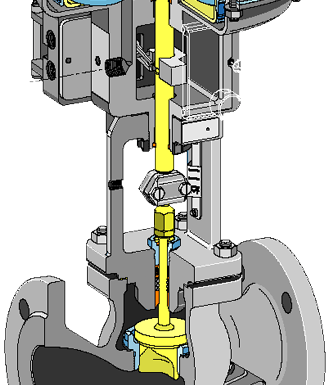

Classification of control valve leakage
Control valves are intended to throttle flows and without valve leakage they are not required to near 100 percent.
The capacity to shut down has to do with valve type. There are very bad shutdown skills for double seated control valves. Moreover-the guide, the seat material, the thrust of the actuator, the pressure drop and the type of fluid all play a role in how well specific control valves shut off.
There are two kinds of valve leakage: fugitive emissions from the valve to the atmosphere, and leakage through the valve but within the piping scheme. Fugitive emissions can be harmful to the environment as well as a potential risk to safety.
Reasons that Valves Leak:
Common causes of leakage of valve include: –
  • Valve is not completely closed. This may be due to multiple factors, including
  • Valve seat preventing complete closure owing to rust, line debris, etc.
  • Insufficient actuator travel
  • Valve seat damage, e.g. scored
  • Valve seals damage
