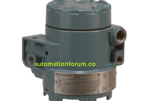

Working of I/P Transducer
Introduction
  • I/P Transducer accepts an electrical input signal and produces a proportional pneumatic output.In this session we are going to discuss about how I/P transducer works.
