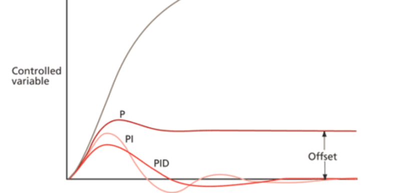

A response graph of a proportional control system includes all three parameters.
OFFSET:
For every controller it’s ultimate aim is to get the process variable to the setpoint value. For a Proportional control system, it is impossible to return the measurement exactly to its setpoint. since proportional output only adjusts in response to a change in the error, not to the error’s duration. This steady gap/error between SP and PV is called offset in process control.

The offset is determined by the controller’s proportional band value and the change in valve position that happens when a disturbance occurs:
?E = PB (?O)/100
where: ?E = Error shift
PB = Proportional band
?O = Valve position change
