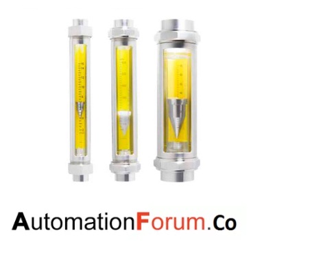

The rotameter is a type of variable area flowmeter that consists of a tapered measuring tube and a float, which can be freely moved up and down inside the tube. The measuring tube is mounted vertically, with the small end at the bottom.
The fluid to be measured enters the bottom of the tube, passes upwards around the float and exits at the top. The figure shows a typical rotameter
RotameterWhen there is no flow through a rotameter, the float rests on the bottom of the dosing tube, where the maximum diameter of the float is approximately the same as the inner diameter of the tube. When the fluid enters the dosing tube, the floating effect of the fluid lightens the float. However, the float has a greater density than the fluid, and the flotation effect is not sufficient to raise it.
There is a small annular opening between the float and the tube. The pressure falling through the float increases and increases the float. This increases the area between the float and the tube until the upward hydraulic forces acting on it are balanced by their weight, less the floating force. The float moves up and down the tube in proportion to the flow rate of fluid and the annular area between the float and the tube. Reach a stable position in the tube when the forces are in equilibrium.
When the float moves up towards the larger end of the conical tube, the annular opening between the tube and the float increases.As the area increases, the pressure difference across the float decreases. The float will assume a dynamic equilibrium position when the pressure differential across the float plus the float effect balances the weight of the float. Each flotation position corresponds to a particular flow and not to another for a fluid of a certain density and viscosity. You take the flow reading from a calibrated scale in the tube The position of the float in the measuring tube varies in a linear relationship with the flow rate.
