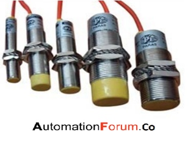

What is the proximity switch?
A proximity switch is a sensor that detects the presence or absence of an object without contact. Common types include inductive (for metal objects), capacitive (for various materials), and ultrasonic (using sound waves). It’s widely used in automation.
A proximity switch is used to determine how close an object is, or the proximity of an object. The proximity of an object is determined by using certain means such as magnetic, electric, or optical. So these switches can be used to check the presence of an object. These switches are widely useful for many security processes. These switches can be used to check the motor rotation speed. Proximity switches can detect the approach of a metallic device part with the help of a magnetic or electromagnetic field. Normal proximity switches use a permanent magnet so it can create a sealed switch mechanism if an object’s mechanical part come close to it. There are certain types of proximity sensors that can act as a metallic detector and this type can be considered as the complex proximity switches. The complex proximity switches operate by energizing a coil of wire by using electric current, the magnitude of the current is monitored electronically. The monitoring section would trip if a metallic part gets close to the coil.

1.Inductive proximity switches
Inductive proximity switches can detect the presence of a metallic object without any contact with the object. The switching speed of inductive proximity switches is very high and that’s a reason why it is widely used in the automation field. This type of proximity switches has a coil driven by an oscillator. An electromagnetic field is created by the oscillator that would reach the active section of the switch. So if the metal part comes close to this part, then the electromagnetic field is reduced and the switch would turn on or off. By using inductive proximity sensors we can determine the metallic object, position of the metallic part in a machine, it can also detect small metallic parts such as screws and rotation speed of the device that can be checked if the rotational part is metal. It only detects conductive material and operating distance up to 50mm. it also has high noise immunity
