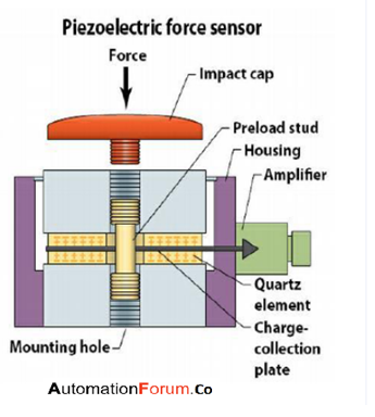

What is a piezoelectric sensor and where is it used
The piezoelectric sensor works on the principle of piezoelectric effect, thus it can measure the changes in acceleration, pressure, temperature, etc. The measurement is done by converting it into an electric charge. Piezoelectric pressure sensor measures dynamic pressure, they are not suited for static pressure measurements. A piezoelectric sensor is an active sensor and it does not need the help of external power as it is self-generating.
What are the materials used for piezoelectric transducer
The materials which are used for the measurement process must have certain properties like stability, high output, insensitive to extreme temperature and humidity and it must have the ability to formed or machined into any shape. Quartz is mostly used as the piezoelectric material because of its stability. This material is mostly shaped into a rectangular or square plate and it would be held between two electrodes. Crystal is connected to the appropriate electronic circuit to obtain the proper output.

  • It is used as an accelerometer, because of its excellent frequency response
  • It can be used to measure force, pressure, and displacement in terms of voltage
  • It is designed to use as a pre-tensional bolt so that both tensional and compression force measurements can be made
