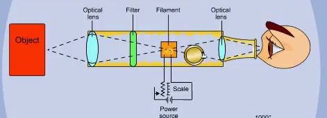

An optical pyrometer will measure temperature from a distance.
Optical pyrometer is a filament that has its power supply and as you adjust the resistance the on it the color will change on the filament.Now the idea is when you are viewing through the view piece,it match the filament to the object surface temperature. Which will be a certain a certain amount of current.Now that current will be converted to a display showing the degree of temperature
Optical Pyrometer - Temperature Measurement
