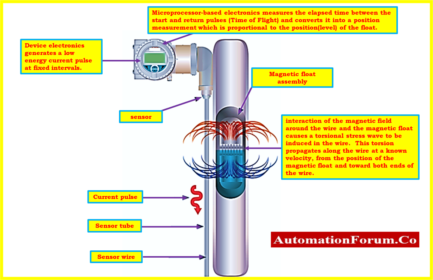

Magnetostrictive level transmitters are continuous float level sensors that measure level in almost real-time by using two opposing magnetic fields to create a signal that corresponds to the level of liquid.
Magnetostrictive float level measurement sensors are made up of three major components. In the fluid being monitored, a hollow stem with a waveguide constructed of ferromagnetic material is suspended.
Along with the liquid’s surface, a hollow float travels up and down the stem. A permanent magnet is embedded inside this float.
As the float travels, its magnetic field modifies the alignment of the magnetic molecules in the stem’s waveguide.
The electronics of the device make up the third element. The electronics produce an electromagnetic pulse at regular intervals. When it moves through the waveguide, this pulse generates a magnetic field of its own. Conflicting magnetic fields in the waveguide cause vibrations when this pulse hits the float, which causes a torsional stress wave, also known as a strain pulse, to go back up the waveguide at a predetermined rate.
A part of the electronics that transforms mechanical energy into an electronic signal is what senses the strain pulse. The distance between the device electronics and the float is then accurately determined by measuring the interval between the initial pulse and the returning strain pulse using an electronic chip.

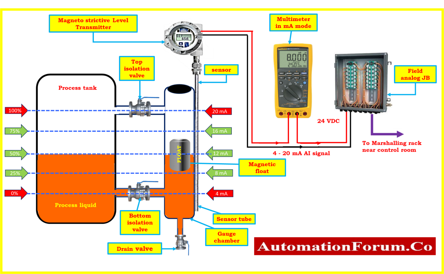

- Use probes and a lead to connect the multimeter (mA mode) in series with an analogue input loop between the junction box and the magnetostrictive Level Transmitter.
- If the magnetostrictive level transmitter is smart, you should also connect the HART field communicator to the terminal for the magnetostrictive level transmitter.
- As indicated in the above diagram, the connections have been established and are currently being readied for the calibration of the magnetostrictive level transmitter.

- To drain the fluid from the chamber, close the top and bottom isolation valves connected to the magnetostrictive level transmitter’s gauge chamber and open the drain valve.
- The drain valve should now be closed, and the chamber of a magnetostrictive level transmitter gauge should be manually filled with process fluid through the bottom isolation valve until it reaches the 0% percentage mark on the chamber.
- You should now look at the multimeter, which should be showing a 4mA output from the magnetostrictive level transmitter.
- Locate the zero adjustment option on the magnetostrictive level transmitter display and make the appropriate changes there until the reading reads 4mA. Alternatively, you may utilize the HART Communicator to make the adjustments for smart magnetostrictive level transmitter.
- The bottom isolation valve of a magnetostrictive level transmitter gauge should be opened to manually fill the chamber with process fluid until the chamber reads 100%.
- Now check the multimeter; it should display a 20mA output from the magnetostrictive level transmitter.
- On the magnetostrictive level transmitter display, find the span adjustment option, and make the necessary adjustments there until the readout reads 20 mA.
- When filling the gauge chamber with fluid, you must ensure that the magnetic float moves very smoothly and that the output of the transmitter is increasing gradually in accordance.
- If it is not possible to establish the level in the gauge chamber using the process fluid, then move the magnetic float to the desired calibration point.
