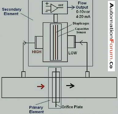

The Differential pressure transmitter is commonly used in industries as pressure measuring instrument. It is a device that measures two opposing pressures in a pipe or a vessel. This equipment will sense the difference in pressure between two ports and produce an output signal with reference to a calibrated pressure range. In the Differential pressure transmitter, as flow increases, the differential pressure increases, and when flow decreases the differential pressure decreases.
What are the main parts of Differential pressure transmitter?
A differential pressure transmitter has 3 functional parts,
  • Direct pressure sensing element (located in lower housing):Almost all differential pressure transmitters are fitted with diaphragm as pressure sensor element. As the diaphragm is mechanical device, it is placed between two pressure inlet ports. The diaphragm will deflect based on the applied pressure and this deflection is converted into an electrical signal. This conversion is usually done by sensors like vibrating wire, strain gauge, differential capacitance.
  • Electronic unit:The electrical signal generated at the lower chamber by the sensor is in the range of milli – volt. This is to be amplified to 0-5V or 0-10V, or to be converted to 4-20 milliamps for onward transmission to a remote instrument.
  • 2-wire 4-20 milliamp current transmitter:A DC output current is generated that is directly proportional to the pressure range of differential pressure transmitter. The lower range is 4 milliamps and the upper range is 20 milliamps.

  • An orifice plate is placed to restrict the flow of liquid. This restriction creates a pressure drop. And this pressure drop can be converted to flow rate. The differential pressure here can be defined as the difference in higher pressure reading and lower pressure reading. We can use a low pressure calibrator to furnish and measure input pressure.For measuring the transmitter’s output, a milliammeter is appropriate standard. The calibration includes the following steps,
