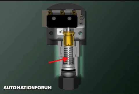

Internal Architecture of Pressure Switch
Deadband is the difference between the value at which a control action occurs and the value at which at which the control action is cancelled. All pressure instruments have some inherent deadband due to moving parts and free play.Pressure control instrument usually have some provision for deadband adjustment.
