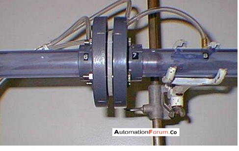

What is orifice meter and what is the use of orifice meter
  • An orifice meter is a widely used device for measuring the flow rate of fluids in a pipeline.
  • It operates based on Bernoulli’s principle, which describes the inverse relationship between the pressure and velocity of a fluid.
  • When fluid flows through the orifice plate, a pressure drop occurs, and by measuring this pressure drop, the flow rate can be accurately determined.
  • Orifice meters are valued for their simplicity, cost-effectiveness, and minimal maintenance requirements, making them popular in various industrial applications.
