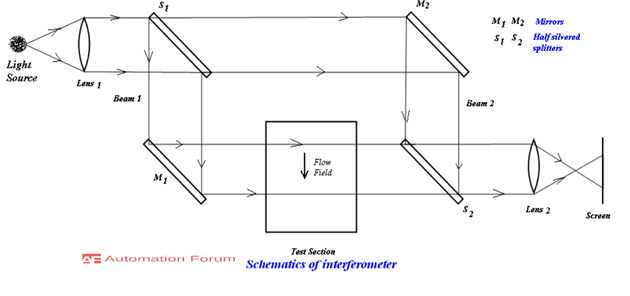

Schematics of interferometer
Light rays from the lens are collimated by lens 1 and split into two streams, one stream to mirror 1 which reflects a parallel beam of light rays to the test section and after that, it is projected on a screen. The second stream passes through the splitter1 projected on mirror 2 which reflects the light to splitter 2 and reunites with the first beam coming from mirror M1 and then moves to the screen. In the absence of flow both the beams give the same pattern of illumination on the screen, but when flow is on various shades of pattern are made up on the screen
