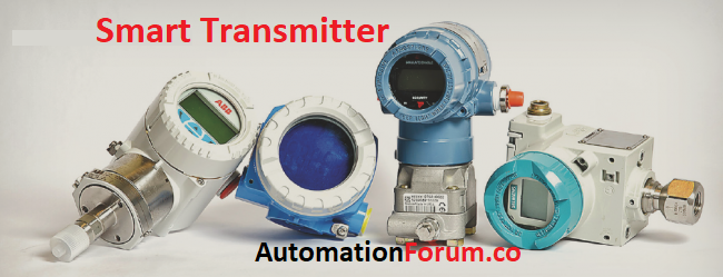

What is a smart transmitter?
A microprocessor-based smart transmitter has a memory that can perform calculations, produce diagnostics and out-perform older, more conventional transmitters when it comes to accuracy and stability.
A Smart Transmitter will also have a wireless communication protocol which can be used to interpret the measurement values of the transmitter and to customize different transmitter settings
