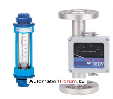

A rotameter has rotating vanes and that’s how it got its name. It can be used to measure the flow of the fluid. The rota-meter has a metal float and a conical glass tube. So the float would rise according to the rate of flow through the tube. Rotameter has a tapered tube and its diameter is small at the bottom, the float in the rotameter can freely move and this float is situated at the bottom of the tube so when the fluid flows the float will rise. The float would only rise until its weight is balanced by the up-thrust of the fluid. So the flow rate is indicated by the position of the float. When the flow increases then the pressure drop in the tube increases so when the pressure drop is sufficient the float would rise and the amount of flow will be indicated.  The rotameter works by the principle of the upthrust force exerted by the fluid and force of gravity. In the variable area flowmeter, the drop rate is constant and the flow rate is the function of the area of constriction. The fluid density must be enough for the movement of the float otherwise the reading won’t be accurate.

1 Glass tube rotameter
2.Metal tube rotameter
3.Plastic tube rotameters
In this type, the tube is made up of glass, and the float will be visible. It is a simple rotameter and has high repeatability. The float is normally visible in the tube and the meter would show the readings on the glass surface.
It is also called armored meters and it is used in places were glass tube type is not applicable like for certain applications the temperature and pressure exceed the glass tube limit. The flow rate is shown by a pointer with the help of a magnet inside the float, the pointer is linked to the magnet. This type doesn’t need any external power.
