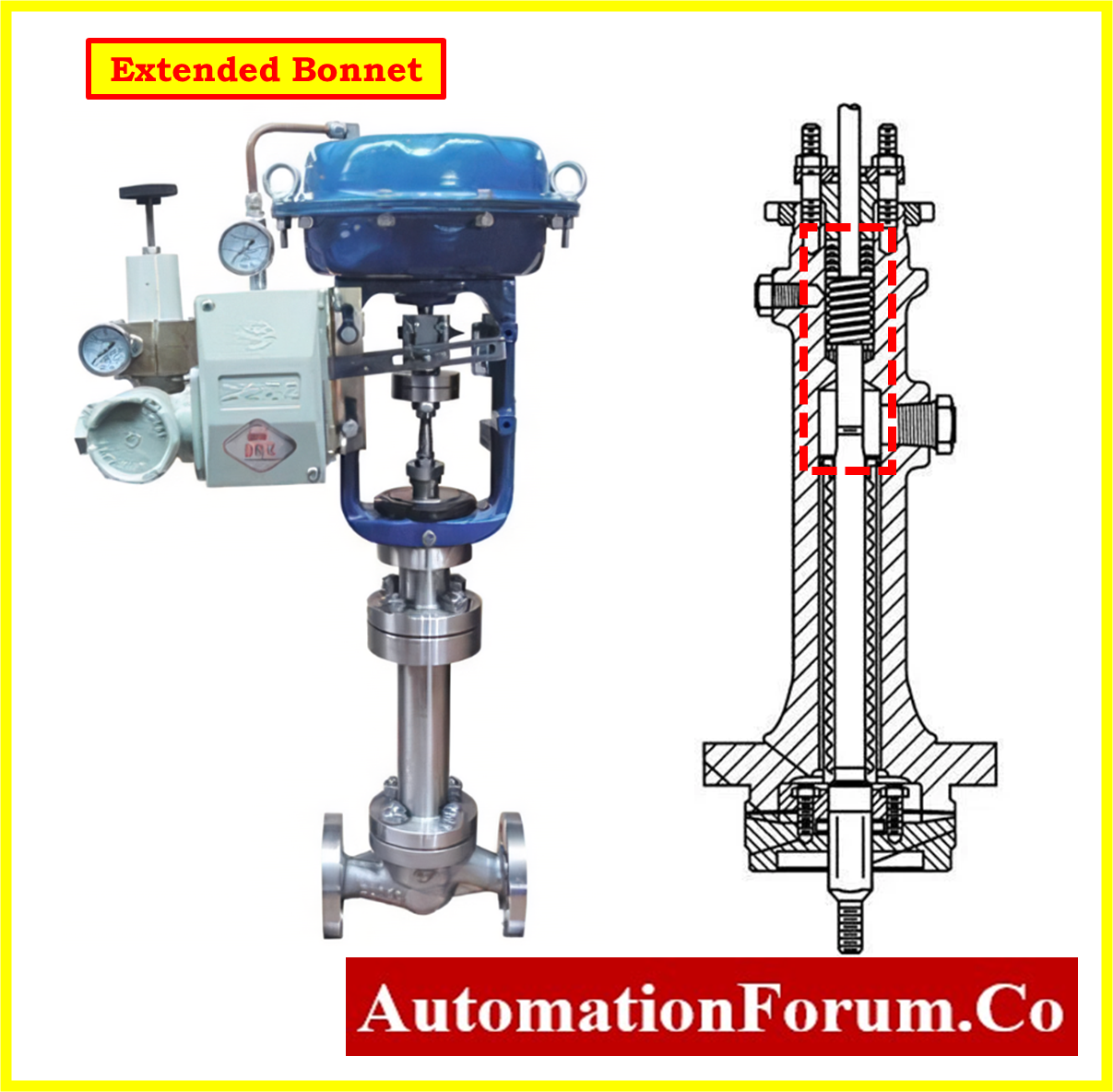

Extended Bonnet
  • Extended bonnets are designed for use in applications with high temperatures.
  • Their elongated design keeps the actuator and packing components away from the high-temperature fluid stream, thus preventing damage or malfunction caused by exposure to excessive heat.
  • Also known as a long bonnet ball valve.
  • Tailored for high-temperature and high-pressure applications.
  • Offers extended length to accommodate insulation and protect packing from extreme temperatures.
  • These bonnets are secured to the valve body using bolts and are relatively easy to remove for maintenance and repair.
  • Bolted bonnets provide a strong and reliable seal and are suitable for a wide range of applications, including high-pressure and high-temperature environments.
