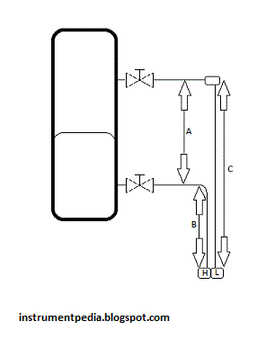

Note:There is many way to perform calibration for DP level but the important thing is the DP reading at HART communicator should same with the LRV and URV
Differential pressure level measurement
Example calculation:
Product S.G=0.89
Glycol S.G = 1.02
A= 2000mm (measurement length)
B= 100mm (off set)
C=A+B=2100mm
Dp = pressure at high side – pressure at low side
LRV = (B x Product S.G) – (A x Glycol S.G)
= (100mm x 0.89) – (2000 x 1.02)
= 89 – 2040
= -1951 mmH2O
URV = (C x Product S.G) – (A x Glycol S.G)
= (2100mm x 0.89) – (2000 x 1.02)
= 1869 – 2040
= -171 mmH2O
Note:
Calculation for apply pressure at high side manifold transmitter
0% = (B x Product S.G)
= (100mm x 0.89)
= 89 mmH2O
100% = (C x Product S.G)
= (2100mm x 0.89)
= 1869 mmH2O
