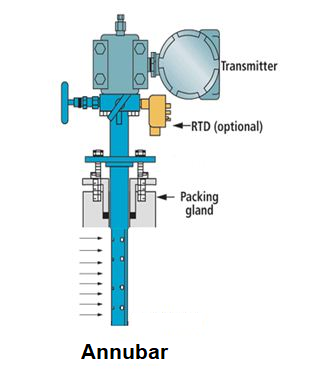

Annubars are sometimes called average pilots and contain multiple pressure taps to “average” the flow; this is to try to compensate for a non-ideal flow profile.
The averaged pitot tube is inserted through the pipe as shown below. One side of the bar has pressure taps facing the flowing fluid and engaging in an “average” chamber that measures the total (ie, static + dynamic) pressure of the fluid.
There may be a single port or multiple outlet ports on the opposite side of the bar to measure the low static pressure in the downstream region.
The difference between the total pressure and the static pressure is effectively a measure of the height of the fluid velocity, which together with the area of the pipeline allows determining the volumetric flow.
