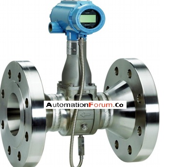

How vortex flow meters are constructed and how does it work
The vortex flow meters are usually constructed by using stainless steel and Hastelloy. The flow meter consists of a bluff body, a vortex sensor, and an electronic transmitter. The bluff body that is used as obstruction can be in different shapes like it could be rectangular, square, etc. The width of the bluff body must be in the range that it can cover the pipe diameter. The pressure oscillation around the bluff body is detected by using piezoelectric or capacitive type sensors.
The working of the vortex meter is based on the bluff body or obstruction and this obstruction is placed perpendicular to the fluid flow. So when the fluid flows through the pipeline it would be in contact with the bluff body and at the time of the contact the flow will continue around the object but when the fluid is in contact with the obstruction, vortex swirls are created on both sides of the object. Vortices are formed alternately from one side to another and because of this pressure fluctuations are created and these are sensed by the sensor. Thus the flow rate is calculated by measuring the vortices.
