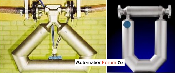

How Coriolis meters are constructed and how does it work
The major components of Coriolis flowmeters are the sensor and a transmitter. The sensor in the Coriolis flow meter is a flow tube assembly. The sensor is connected to the electronic assembly with the help of a cable. The flow tubes which is used are oscillating tubes and the tubes are mostly U shaped. So when the fluid flows through the oscillating tubes a force is created and it is called the Coriolis force and this force will be measured by the sensor. The flow tube will get the oscillation energy from the electronics
The fluid which is to be measured will flow through the U shaped tube and the tube is made to vibrate perpendicular to the fluid flow. So the fluid that flows through the tube will be in contact with this vibration and this would make the fluid twist. So if the twist angle is high then the flow would be good. If there is no flow in the meter but has fluid in the tube then the inlet and outlet sides of the tubes would experience the same force and that would be in the same direction. But in case of flow through the tube then there would be acceleration or change in direction in the inlet side and deceleration in the outlet side. This will create a twist in the flow tubes and this would make the inlet to pick off earlier than the outlet and the magnitude of the time delay between the outlet and inlet sides of the tube is directly proportional to the mass flow of the fluid.
