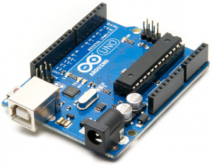

1Arduino Uno (R3)Arduino Uno (R3)The Arduino UNO is a microcontroller board with an ATmega328P processor. It contains 6 analogue inputs, a 16 MHz ceramic resonator, a USB port, a power jack, an ICSP header, and a reset button. It also has 14 digital input/output pins, six of which can be used as PWM outputs.SRAM is 2 KB, EEPROM is 1 KB, and Flash Memory is 32 KB.

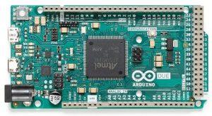

4Arduino DueArduino DueThe Atmel SAM3X8E ARM Cortex-M3 CPU is the foundation of the microcontroller board known as the Arduino Due. It has four hardware serial ports (UARTs), an 84 MHz clock, 12 analogue inputs, 54 digital input/output pins, 12 of which can be utilized as PWM outputs, and USB OTG connectivity.2 DAC (digital to analogue) connectors, 2 TWI connectors, an SPI header, a JTAG header, a reset button, and an erase button.

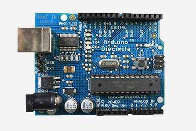

6Arduino DiecimilaArduino Older Boards | Arduino DocumentationBased on the ATmega168, the Arduino Diecimila is a microcontroller board. It has a USB port, a power jack, an ICSP header, 6 analogue inputs, a 16 MHz crystal oscillator, and a reset button.It also has 14 digital input/output pins, 6 of which can be used as PWM outputs.

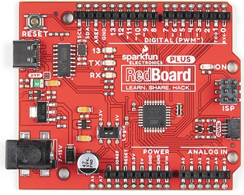

7RedBoard Arduino BoardThe popular ATmega328 microcontroller has 14 digital I/O pins, an Optiboot (UNO) bootloader, and 6 PWM outputs. 6 Analog InputsFlash Memory 32 kCompatible with 16MHz Clock Speed R3 Shield

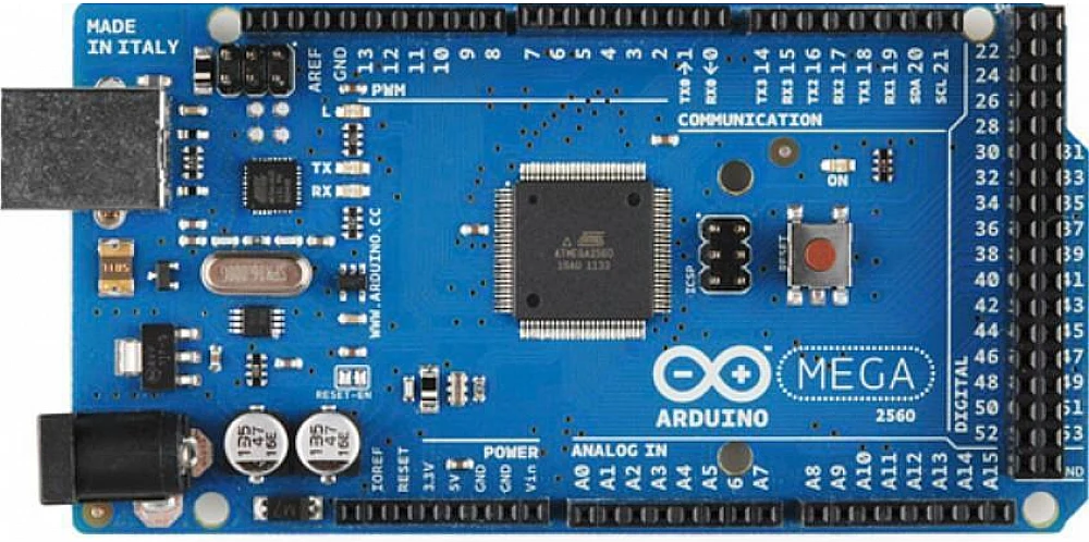

8Arduino Mega (R3) BoardUsing the ATmega2560 as its basis, the Arduino Mega 2560 is a microcontroller board. It contains 16 analogue inputs, 4 UARTs (hardware serial ports), a 16 MHz crystal oscillator, 54 digital input/output pins (of which 15 can be used as PWM outputs), ICSP header, power jack, USB connector, and reset button.

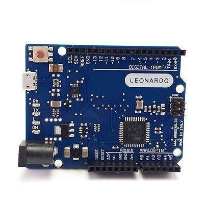

9Arduino Leonardo BoardBased on the ATmega32u4, the Arduino Leonardo is a microcontroller board. It contains a 16 MHz crystal oscillator, a micro-USB port, a power jack, an ICSP header, and a reset button.Additionally, it includes 20 digital input/output pins, of which 12 are analogue inputs and 7 are PWM outputs.
