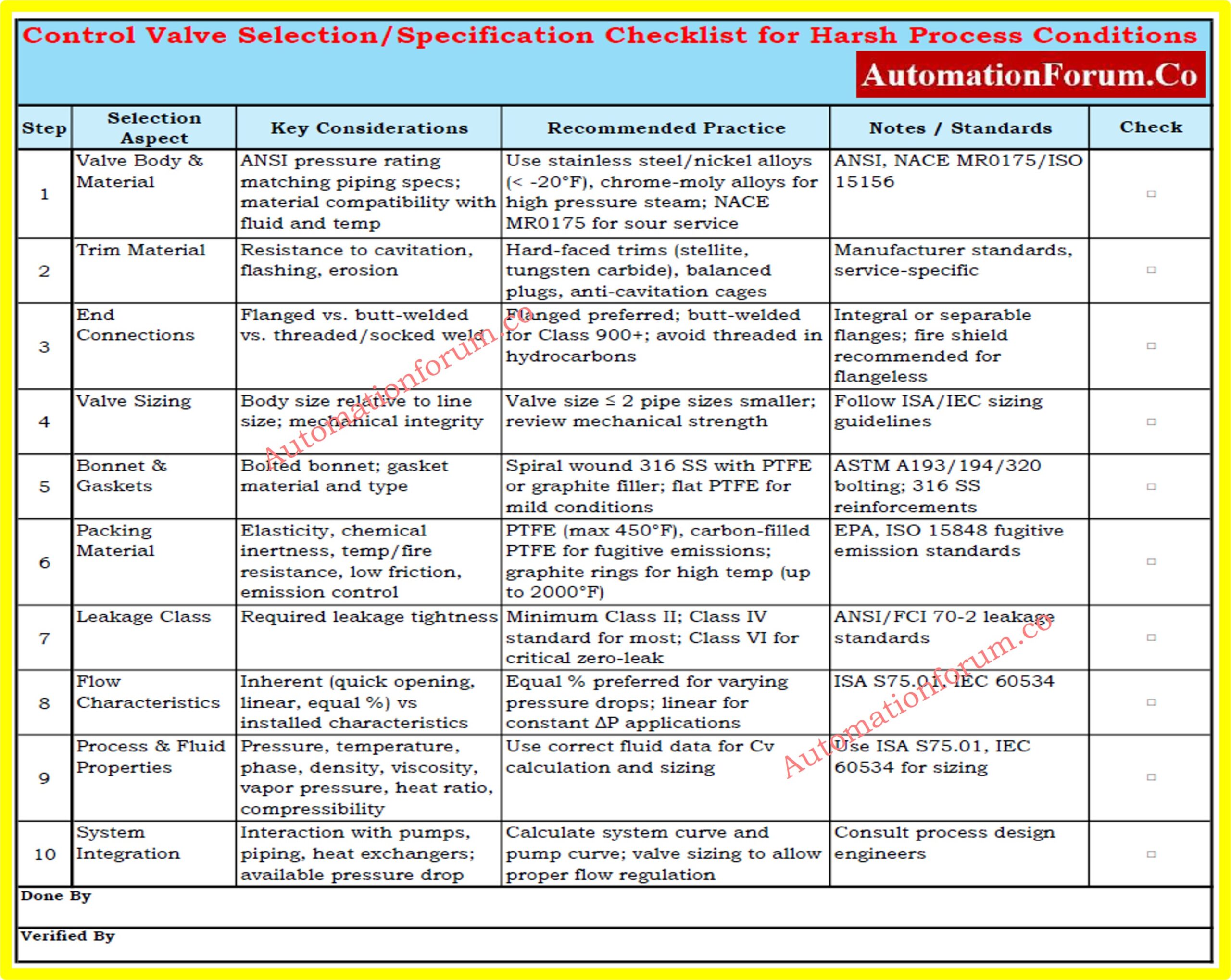

Control Valve Selection and Recommended Practices for Harsh Process Conditions
Control Valve Selection and Recommended Practices for Harsh Process Conditions 4
