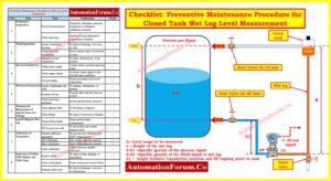

Checklist: Preventive Maintenance Procedure for Closed Tank Wet Leg Level Measurement
This Procedure outlines the preventive maintenance procedures for a differential pressure (DP) type level transmitter used for closed tank wet leg level measurement. Regular preventive maintenance is essential to ensure the accuracy, reliability, and longevity of the instrumentation. Purpose of this Procedure Scope of this Procedure Definitions Responsibilities Safety Precautions Tools and Equipments Required for … Continue reading Checklist: Preventive Maintenance Procedure for Closed Tank Wet Leg Level Measurement
