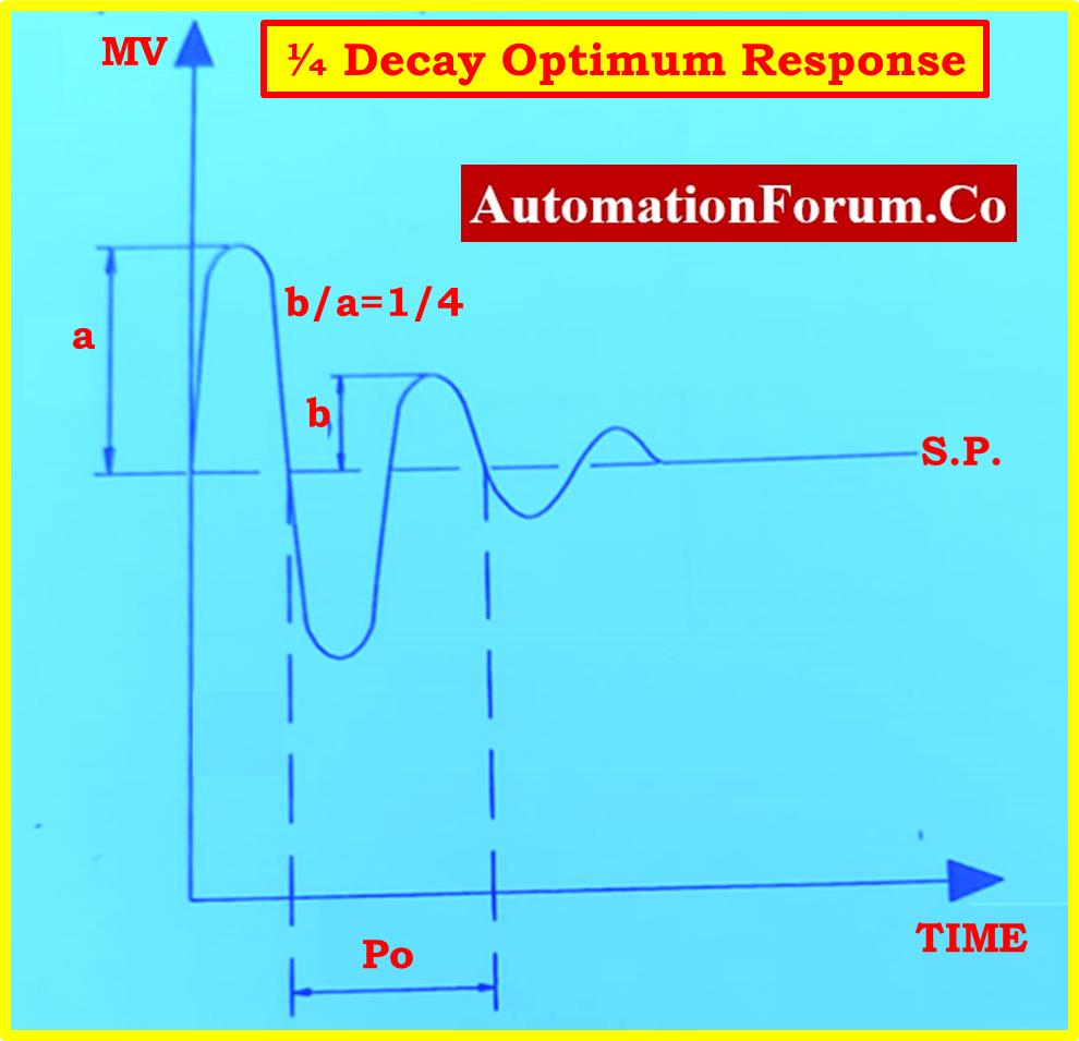

What is quarter decay ratio response?
¼ Decay Optimum response
The M.V response shown is for a process that has been subjected to a load change.
PID controller tuning 2
The response is a compromise between a rapid initial response and a short setting time. The period oscillation Po is the time taken for one cycle to occur.

What is damped oscillation method?
Damped Oscillation Method
This method is often called the 1/4 decay method of tuning. It was again developed by Ziegler & Nichols. The controller parameters are adjusted until a ¼  % decay response of the M.V is  obtained following a load change / S.P change. A fast speed chart recorder or storage oscilloscope is used to measure the response of the M.V to the S.P load change.
Procedure
  1. With the controller in manual adjust the P.B to a safe initial value (if unsure what a safe value is set P.B to its highest value). Set the other control parameters to their least effective value, i.e I.AT to its maximum  time and D.A.T to its minimum time.
  1. Ensure M.V = S.P. switch controller to auto and allow system to stabilize.
  1. Simulate a load change by making a small S.P change either up or downscale (a S.P. change of a few % should be enough).
  1. Observe the M.V response to the S.P change. If the M.V response is not a 1/4 decay then the P.B will need to be adjusted.
  1. Switch the controller to manual.
  1. The response obtained in step 4 is initially more than likely to be sluggish. Therefore reduce the P.B setting (ensure you do not reduce the P.B too much as to narrow a P.B will result in the loop becoming unstable when put into auto).
If the response obtained in step 4 is unstable then the P.B will need to be increase.
Note: There is no definitive value to increase or decrease the P.B by. If in doubt then only make small adjustments until you have a better feel for the system.
  1. Having adjusted the P.B repeat steps 2 to 6 until a 1/4 decay response of the M.V following a S.P change is obtained.
  1. If the controller is a P only type then the loop is now tuned correctly.
  1. If the controller is a P+I or P+I+D type then measure the period of oscillation Po in minutes.
  1. Switch controller to manual.
The control parameters can now be calculated using the information below:-
Proportional + Integral Controller:-
PBC = P.B / 0.9
LA.T = Po
Proportional + Integral + Derivative Controller:-
PBc = P.B / 1.2
I.A.T = Po x 0.6
D.A.T = Po / 6 = X secs thus X / 60 = DAT setting for the controller
11. Set controller parameters to values calculated above.
12. Ensure M.V = S.P and switch controller to auto.
13. The controller should now be tuned correctly. Check this by making a small S.P change and observing the M.V response.
The M.V. should have a 1/4 decay. If it’s not, you should examine your calculations.
If your calculations are correct then the controller may need fine tuning remember to put the controller on manual before adjusting any controller parameter).

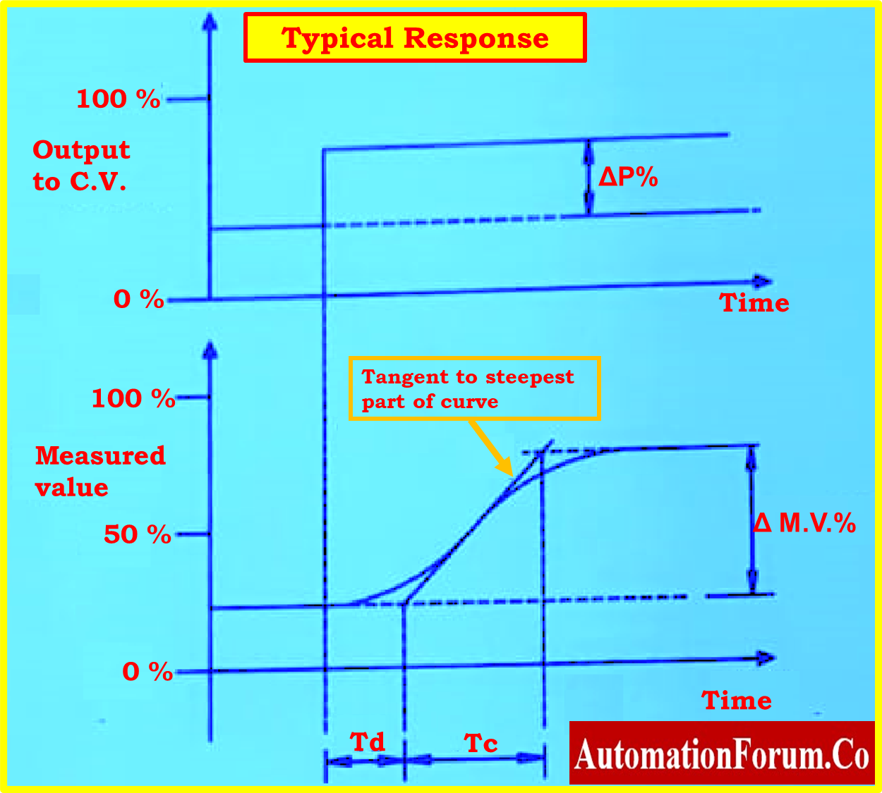

What is meant by process reaction curve method of PID controller tuning?
Process Reaction Curve Method
Again this method was originally developed by Ziegler & Nichols. Consider the block diagram shown below:-
PID controller tuning 7
It can be seen that the controller is set to manual control. A step change is then made using the manual output adjustment of the controller and the resulting process response is observed. The name for this kind of response is the “process reaction curve.”
Typical Response of the controller
PID controller tuning 8
ΔP% = Change in output to control value in %.
Td = Apparent dead time in min.
Tc = Apparent time constant in mins.
ΔM.V.% = change in measured value in %.
Using the information obtained from the process reaction curve the controller parameter now be calculated using the following information-
Proportional Only Controller:
P.B ={ 100 x (ΔM.V ÷ Tc ) x Td} ÷ ΔP
P.B ={ 110 x (ΔM.V ÷ Tc ) x Td} ÷ ΔP
IAT = 3.33 x Td
P.B ={ 83 x (ΔM.V ÷ Tc ) x Td} ÷ ΔP
IAT =2x Td
DAT = 0.5 x Td
When using this method on a live system the following procedure should be followed
Procedure
  1. Ensure M.V is at a suitable value and put controller into manual (make a note of M.V at this stage).
  2. Allow the process time to stabile and the make a step change of the controller output
  3. Be careful to record a “process reaction curve” in the appropriate format.
  4. Return controller output to its previous value and ensure M.V returns to value noted in step 1.
  5. Calculate the controller using the “process reaction curve” and information given previously.
  6. Set the controller parameters to values calculated.
  7. Ensure M.V – S.P and switch controller to auto.
  8. The controller should now be tuned correctly. This can be checked by making a SP change and observing the M.V response.
